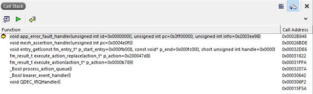

proxy_enable()/proxy_start() cause an assert when using alongside flash manager module (nRF Mesh SDK).
Hi, I'm having a bit of an issue with the proxy_enable() & proxy_start() functions when they are used in tandem with the flash manager module.

Calling proxy_stop(); in this manner seems to be fine - the proxy is stopped and then the mesh is disabled. The device is then in its lowest power state.
When I try and re-enable the mesh one of the functions, either proxy_enable() or proxy_start() (not quite sure which as the call stack isn't clear) triggers an assert "Mesh assert at 0x00032DE8". From the call stack:
It seems there is some interference from the flash manager causing this behavior.
