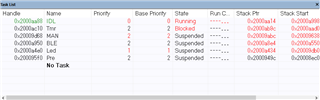

 After applying that, I can get proper sleep current. But, In my situation, I met some different situation
 It looks like memory corruption is occurred.
Below Image is normal situation, If I use original code which is not handle FPU interrupt,  Information of tasks is shown correctly. "BLE" task is created for softdevice
But, If I handle FPU interrupt before goes to sleep mode, As you can see below, It looks like Information of "BLE" task is corrupted.
After those situation is occured, BLE doesn't work properly.
Do you have any idea what do I need to check in this case?
Or Is there any proper way to handle FPU interrupt in using FreeRTOS?
