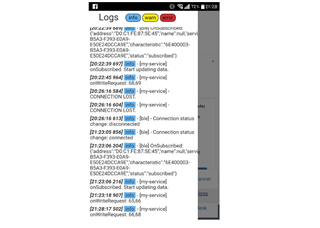

ble_nus_c: the received packet is only 1 byte long while I send more than 1 byte
Hi nordic,
I send multiple bytes but always only receive packets of length = 1. For example in the picture, I sent 2 bytes 0x68, 0x69 ('DE') but only received the first value ('D'). I did not intentionally change the code of the file: ble_nus_c.h / .c (add only one line log_info as shown in the picture).
Maybe I accidentally fixed something that I didn't know. Please help me solve this problem.
