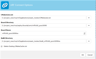

How to delete the build folder.I mean where do you find it?
I had update the tag to v0.4.0 and proceeded with the next steps.
When configuring examples that communicates with the modem, remember to choose the board type "nrf9160_pca10090ns". This is important, if not it will not compile or work properly.
Cheers, Håkon
the board type is the same as you have mentioned.The build still gives the same errors.
