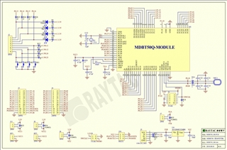

LFCLK request gives Fatal error
I modified template example and now I am trying to add usb cdc. The applicaton results in Fatal error.I found that nrf_drv_clock_init() works fine but nrf_drv_clock_lfclk_request(NULL); gives Fatal error.
ret_code_t err_code = nrf_drv_clock_init();
while(!nrf_drv_clock_lfclk_is_running())
    /* Just waiting */

among other parameters as in usb cdc example but still gets error (I compared sdk_config.h and project includes with usb_cdc_acm example).
Could you please let me know why is it happening?
nRF52840 - Raytac Corporation MDBT50Q Module. (has 32.768 kHz crystal) image attached.
SDK 15.2
