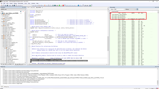

Hello, I have a problem with staring "Run" in the "debugger mode" . I used Rigado evaluation board with BMD300 (nrf52) and also work with nrf5 SDK_15.3.0 Examples. Sometimes I have problem with push the button "Run" in the Debugger mode, sometimes it is ok.
I have already read this article https://www.iar.com/support/tech-notes/debugger/application-does-not-run-stand-alone/
Log:
