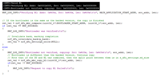

I'm using sdk12 , S130 on NRF51822, so far successfully updated application, soft device and BL, however
lately after changing the size and starting address for the DFU the BL software fails to update itself and not even returns to BL state, the device fail completely after the end of the upload (after reaching 100% transfer)
To my understanding and after some debugging it happens after comparing the new banked version,
ret_val = nrf_dfu_mbr_compare((uint32_t*)BOOTLOADER_START_ADDR, (uint32_t*)src_addr, len);
and than
ret_val = nrf_dfu_mbr_copy_bl((uint32_t*)src_addr, len);
that is sending a  SD_MBR_COMMAND_COPY_BL, command
at that points that system stops completely
would appreciate some insights, on why does this happens and can it be fixed
Thanks !
    Changing the bootloader size via DFU is not supported. Even if you were able to copy the larger bootloader in place, it still would not work as the MBR will branch to the bootloader address that is specified in UICR. And the UICR cannot be programmatically deleted (to be updated) on the nRF51, so there is absolutely no way you can achieve this with Nordic's DFU solution.
