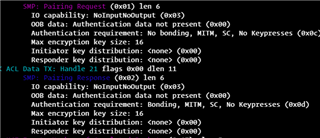

MITM set when using JustWork option, how is this possible?
When pairing with nRF Connect and nRF52 I use the Just Work mode. No Keyboard No Display.
In 4.2 (and also 4.0) the MITM cannot be used in this mode.
If I set it on the pairing nRF Connect option, the MITM is set. Is this correct?
According to the specs this should not be. Pls see below the btmon message. I have NoInputNoOutput which is equal to Just Work and we can see the MITM is set.
