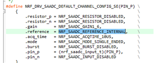

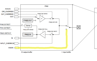

I use the SAADC with the NRF52832.

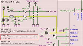

This is the schematic used :
When we use AN_IN (TOR_IN 1 and TOR_IN 2 are not used), only the components assigned to AN_IN are mounted on the board. The consumption increase when we put a voltage on T20 (input P0.03=> D6 on the WLCSP ball assignments) from an external power supply. We d'ont use the internal pull-down or pull-up on P0.03.
Example for various voltages on the PIN T20:
  • 106µA when i put 3V
  • 61.62µA for 2.5V
  • 5.19µA for 1.5V
  • 380nA for 1V
Can you help to understand this over consumption please?
