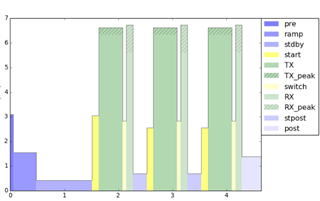

I'm surprised to see this kind of power profile when the device is in advertising mode.
The 3 TX steps for the 3 canals of advertising haven't got the same max value.
Also my maximum value for +4dBm TX power is less than 4mA
In theory the maximum value is about 8mA and the 3 steps have the same max values.
