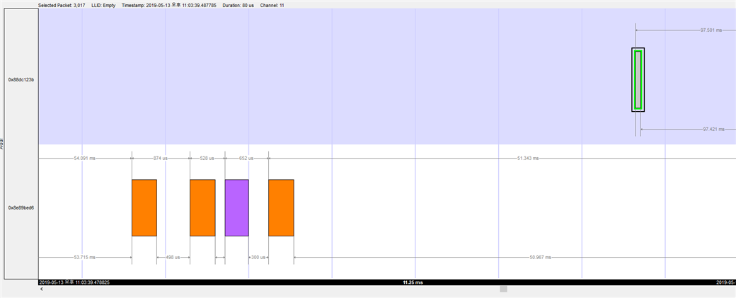

Following 2 captures show failing case.
IFS between orange(ADV_IND) and purple(CONNECT_REQ) is 152us both normal and failing case.
nRF5 keeps adverting and does not respond to master's packet.
Fail 1
fail 2
I don't think it's from interference because of the first failing case.
Here is the zoomed-in picture of the first failing case.
nRF5 has definitely received the purple packet and we know it from the fact that the third ADV_IND is deferred ( 528us + 652 us ).
Usually, the third ADV packet is sent around 874us after the beginning of second ADV packet.
CONNECT_REQ Ignored
I hope it is not an inherent problem of nRF5.
Please give me some measure to get around this problem.
I think it may help if the gap between ADV packets in one event can be widen.
Thank you.
Jake
  • Hi Jake,
    The fact that the next advertising packet in the same advertising event is delayed indicate that the nRF has at least partially received the CONNECT_REQ, but ignores it. This can happen for a couple of reasons:
    • CRC failure in the received packet (caused by low RSSI or noise/interference).
    • Whitelisting is used, and a non-whitelisted peer attempts to connect.
    • Directed advertising is used and another peer attempts to connect - do you by any chance set p_peer_addr in the ble_gap_adv_params_t?
    The CONNECT_REQ should always be transmitted 150 μs (T_IFS) after the end of the advertising packet, which there is plenty of room for, so I do not think this is related.
  • whitelisting nor directed advertising is used in my case.
    No other master is trying to connect to my device.
    And "p_peer_addr" is explicitly set to "NULL".
    RSSI is not low because they are very close.
    The only remaining suspect is CRC failure caused by noise/interference.
    I may try it in RF anechoic chamber later.
    Thank you, Einar.

  • Hi Einar,
    I've tested it again with LG Q7 in shielded area and it did not happen.
    I repeated it in shielded area and in my office.
    I must agree that it's from outside anyway.
    It might be SCAN_REQ from other phones.
    As far as I know, there is no way for connectable device to advertise itself as not scannable, isn't it?
  • Hi Jake,
    Thank you for reporting back. That makes sense.
    Yes and no. You cannot do nonscannable connectable undirected advertising unless you use extended advertising. However, you can use an empty scan response packet, which is used in many SDK examples.
