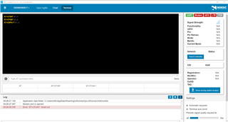

     Can you please provide a screenshot of the LTE Link Monitor?

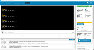

  • The monitor is acting different this morning.
    Also, I'm not sure this is a good location for cellular connection.  I'll try everything again at a better location this weekend.
    Here is Monitor snap shot

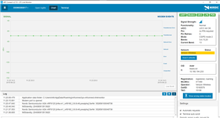

  • More interesting (promising?) information regarding mqtt_simple.
    I decided to re-build and re-download mqtt_simple on the board in a very strong cellular area.
    I also decided to activate the LTE_Monitor instead of the terminal emulator.
    When I reset the board, I got the same boot-up and the same error messages....
    ***** Booting Zephyr OS v1.14.99-ncs1-587-g5c5ba77d0170 *****
    The MQTT simple sample started
    LTE Link Connecting ...
    LTE Link Connected!
    ERROR: getaddrinfo failed 22
    ERROR: mqtt_connect -47
    Per earlier instructions, I send the command AT+CFUN?.  On the third try, the board sprung to life - the modem activated and the terminal every 10 seconds or so would send "AT+CESQ" and the device would respond with +CESQ: 99,99,255,255,255,76
    Eventually the "LTE" indicated it was searching.  It did this for awhile until I sent another AT+CFUN? command (using the push button this time).
    Everything now seems to be connected.
    Here are a couple of screen shots.
    I'm not sure how to attach the log file, if you are interested.
    This looks very good to me.  (Please tell me if I am being overly optimistic.)
