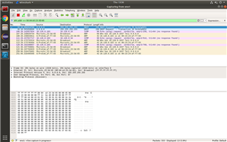

  • I had screenshot of wireshark log. Following are the sequence of events that you can observe in wireshark:
    * IP Address of my device is 10.128.8.16 and IP Address of the PC from which I am initiating ping is 10.128.8.103.
    * Wireshark is running on PC with IP address 10.128.8.103.
    * From the attached image we can observe that PC has sent ping request to my device.
    * After that, device has sent a broadcast message seeking for the owner of IP Address 10.128.8.103(PC).
    * Then, PC has responded with its MAC ID.
                     These are the sequence of events that are occurring. I hope this log helps you in understanding the situation. Please let me know if you need more information.

  • Do you have any logs from the modem or the nRF device?
    This ethernet sniffer trace only tells us that you got no reply to your ping.
