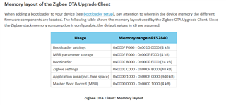

For my graduation project i'm developing an improved version of the Nordic Secure DFU Boot loader. I'm trying to integrate something like the Zigbee OTA client inside the boot loader. Currently i'm working on an attempt for a kind of dual boot. I'm trying to use the standard partition layout with the supplied MBR, my plan is to integrate the Zigbee OTA client on 0x0000 1000 right after the MBR and an application right after the OTA client. I've modified the boot loader in such a way it will boot the OTA client when the DFU button is pressed and the application for normal boot operation.
Given these facts i've come up with two options:
Option 1:
Try integrate the OTA client inside the boot loader but i doubt if that is possible, perhaps someone can provide me with some information on if it's possible or if there are some serious limitations.
Option 2:
Continue like i've described at the top, in such case i'm thinking it would be ideal if i could implement the OTA client like some kind of soft device. But i'm thinking that is not possible since the provided soft devices inside the SDK are not open source.
Let me summarize this, my first question is: Can i integrate a Zigbee OTA client inside the boot loader or are there some serious limitations? Is it possible to implement the Zigbee-stack as soft device? Or should i continue with what i'm doing now?
