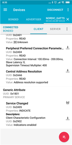

And I want send service change indication from client to server. In gatts_c I enable service change characteristic in sdk_config.h . And in my code :
      case BSP_EVENT_KEY_0:
        sd_ble_gatts_service_changed (m_conn_handle,0x000C,0xFFFF);
But I don't see anything at server side.
Then I using an Android connect with client GATT. My android find out service change characteristic. But when I push button 0, I don't see any changes on android.(I enabled service change characteristic on android. I think It will rediscovery service of client GATT.
Please show me a right view about service change characteristic

  • Hi Giang,
    Please check the error return code of sd_ble_gatts_service_changed() function. Make sure it's successful.
    Also the CCCD to enable indication should be enabled (in your app it's enabled, but I'm not sure about the Device 2)
    Please be aware that on the phone Android/iOS, I don't think that the app would receive an event when the service changed indication is received. It's handled by the OS itself .
    I would suggest to use the sniffer trace to check if the indication is actually sent.

  • When you use a function, please have a look at the description of the function (in the .h file) to see how it work and which error code can be expected from that function. In this case the description is in ble_gatts.h.
    The error code 12291 = 0x3003 = BLE_ERROR_INVALID_ATTR_HANDLE
    You need to use the handle range inside the range of handles you have in the attribute table.
