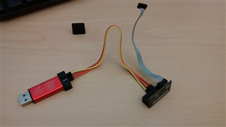

  • I didn't write anything about that in that file, no. However I do have one of the knock-off ST-Link V2 dongles (similar to the Adafruit one) and I have gotten it to work with the nRF52 chip using OpenOCD. (In my case the nRF52840, but that doesn't matter.)
    The main problem with the cheap knockoff ones is cabling it up to the board properly. The nRF52 boards I have all use the mini 10-pin SWD header, while the ST-Link dongles come with a 4-wire patch cable which doesn't fit the pins. I have yet to find a proper cable to go directly from the dongle to the SWD header. I have another 20-pin to 10-pin adapter which has a 20-pin socket, and I was able to fit the patch cable connectors to the pins on that socket, and then connect the 10-pin cable on the other end to my nRF52 board. It was a bit awkward because the patch cable doesn't grip the pins very well and you have to hold it still or else it'll lose connectivity.
    In my case I connected the GND, Reset, SWDIO and SWCLK pins. Really GND, SWDIO and SWCLK are the only 3 pins that matter. I don't have it set up now, but I can try to set it up later and post a picture. I didn't document that specifically because I wasn't sure what cabling to recommend since I basically just kludged something up with what I had available.
    -Bill
  • Below is a photo showing how I connected up the ST-Link V2 to the 20/10 pin adapter:
    The 20-pin connector has the standard ARM pinout, as shown below:
    The connections from the ST-Link to the 20-pin connector are:
    RST <--> pin 15
    SWDIO <--> pin 7
    SWCLK <--> pin 9
    GND <--> pin 10
    I use the following command with OpenOCD:
    openocd -f interface/stlink.cfg -f target/nrf52.cfg -c "gdb_flash_program enable" -c "gdb_breakpoint_override hard"
    When I run I get this:

    This is with an OpenOCD built from the current git repo. My host system is FreeBSD/amd64 11-RELEASE. From here I use GDB to debug and flash the chip. (I built my own GDB with --target=arm-none-eabi.) Again, this is with an nRF52840 chip, but it works the same with the nRF52832.
    I don't use SES so I don't know if there's any special configuration needed for it.
