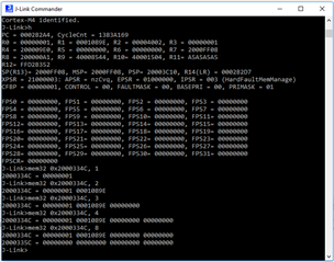

I am developing an application using an nRF52832, nRF5_SDK_12.1.0_0d23e2a and Softdevice s132 v3.0.0. The BLE part of the application involves sniffing advertising packets, but not ever making a connection.
I have found that after an indeterminate amount of time (sometimes a day, sometimes longer than a week), the app crashes into app_error_save_and_stop(). This has happened several times using different hardware.

Since I haven't been able to catch this error while a debugger is connected, I've had to read out what little info I can by connecting a debugging to a running (but crashed) device, halt the core, and read off PC values etc.
From this I have tracked down that the current PC value is 0x0002B2A4, which from the map file I know is inside app_error_save_and_stop(). Also from the map file I have found the memory location for the variable m_error_data, which is 0x2000334C. Reading off the data at this location gives the following:
J-Link>mem32 0x2000334C, 8
2000334C = 00000001 0001089E 00000000 00000000
2000335C = 00000000 00000000 00000000 00000000
So from this I have determined the fault_id is 1 (this is a NRF_FAULT_ID_SD_ASSERT), the PC right before it crashed was 0x0001089E, and since this came from inside the SoftDevice, no other info (line num etc.) could be saved and is therefore zero.
Using the fact that the PC = 0x0001089E right before it crashed, is someone able to provide some insight into where within the SoftDevice this error occurred, and what may have caused it?
