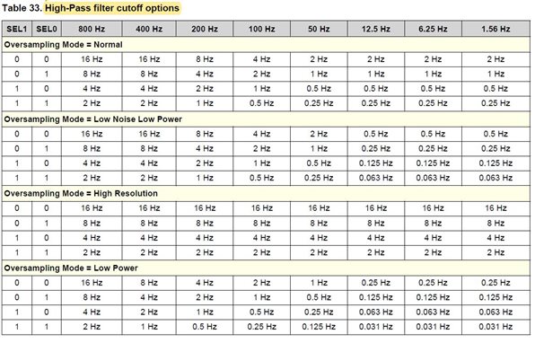

nrf52832 , using MMA8652FC sensor
Hello. I tried to understand MMA8652FC Acceleration sensor with 52832.
I don't know what means 16Hz, 8Hz, etc. under table.
I know just concept of  High pass filer. that is the frequency that higher than cutoff pass the filter.
Do you help me any Info or what is that?
