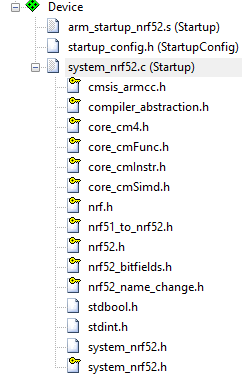

I try to import a project from Keil to SES,
I 'v read the instructions in this article.
Segger Embedded Studio - A Cross Platform IDE
Generally I have no question about those steps except one,
When mention "Adding nRF5 MDK Files", it offers two links to download the required files.
I noticed the files are entitle with "ses...", whereas in my original project it is "arm...".
As far as I know, "arm_startup_nrf52.s", "start_config.h" and "system_nrf52.c" revise as the version of "Device Family Pack" increases in Keil(Currently I'm using 8.24.1 in Keil),
I suppose the startup file to be used in SES should follow the same pattern which I expect there will be a website where I can browse every revision and chose the one I need.
However there isn't(not sure if I use the right key words on Google), so I start to think if I can just take the files from Keil and import it to SES?
Then I compared the content of "startup_nrf52.s" between SES's and Keil's, discovered there are many differences which makes me wonder if can do so?
