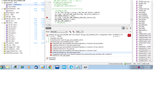

  • hello kenneth,
    now i am able to transmit 500 bytes of data from slave to master with 100 ms time period. but its working upto 10 meters range . we want it up to 80 meters range.we are using (#define TX_POWER_LEVEL  8) max level. after 10 meters range board is unable to pair and reconnect. To solve this situation i have implemented watchdog timer.but i am facing problems.
    can you please help us to resolve the range problem and wdt implementation issue.
