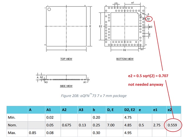

nrf52840 mechanical specification issue
Dear Nordic team
It seems there is a small mistage in the mechanical specification of the AQFN package in the nrf52840 datasheet v1.1 p582
The e2 dimension seems wrong : as far as I understand, it should be 0.5mm * sqrt (2) = 0.707mm and not 0.559mm as stated in the datasheet which is a little bit confusing.
However, the e2 dimension is not needed to make the footprint and is redundant. Yoy can just remove it from the next issue of the datasheet I guess.
best regards
Olivier
