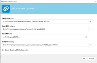

we are  using latest repository, did "west update" to pull the source code. Followed nrf connect application "getting started assistant" to setup the environment.
All the examples in "ncs\nrf\samples\nrf9160" are working fine.
Except "spm", all other examples are builds as "build_nrf9160_pca10090ns" and works fine. - is it expected to build app in non-secure way?
asset_tracker application  also build and flashed in same way, but we are getting "Exception occurred in Secure State" and log attached below.
Modem firmware updated to latest.
Tried flashing/building through SEGGER and command line and no luck getting same error.
options used:
Error log:
