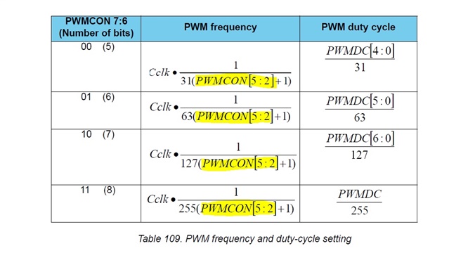

in the nRF24LE1_PS_v1.6.pdf mentioned the pwm Frequency-range from 4 kHz to 254 kHz (when MCU is clocked at 16 MHz), First, may i know what the pre-scale value we chose to get the 4 kHz and 254kHz?
second, what is the available value for PWMCON bit5-2: PWM frequency pre-scale factor , is it from 0~15 ? all the 16 values can be chose ?
Please kindly advise, thank you ~
    4kHz: PWMCON (7:6) = 0b'11, and PWMCON[5:2]  = 15
    This gives 16M clk * 1 / (255 * (15+1) = ~4 kHz (generating an effective 2kHz pulse)
    254 kHz: 4kHz: PWMCON (7:6) = 0b'00, and PWMCON[5:2]  = 0
    16M * 1 / (31 * (0 + 1) = ~516 kHz (generating an effective ~258 kHz pulse)

    So, the documentation is incorrect, as the PWM peripheral itself will be between 4 kHz and 516 kHz, with an effective output frequency of between 2 kHz and 258 kHz.
    As per the first picture you attached, you can set the prescaler from 0 to 15. You are free to choose any value between.
