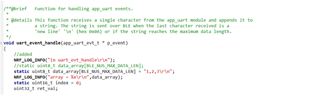

  • You've still just shown the definition of the array - you haven't show how you actually use it!
  • Okay. I have declared the data_array[BLE_NUS_MAX_DATA_LEN] in the function  uart_event_handle(app_uart_evt_t * p_event)
    and i am passing it as a parameter in the function
     ble_nus_c_string_send(&m_ble_nus_c, data_array, index);
        //added
        NRF_LOG_INFO("in uart_evt_handle\r\n");
        //static uint8_t data_array[BLE_NUS_MAX_DATA_LEN];
        static uint8_t data_array[BLE_NUS_MAX_DATA_LEN] = "1,2,3\r\n";
        NRF_LOG_INFO("array = %x\r\n",data_array);
        static uint16_t index = 0;
        uint32_t ret_val;
        switch (p_event->evt_type)
            /**@snippet [Handling data from UART] */
            case APP_UART_DATA_READY:
                index++;
                if ((data_array[index - 1] == '\n') || (index >= (m_ble_nus_max_data_len)))
                    NRF_LOG_INFO("Ready to send data over BLE NUS");
                    do
                        ret_val = ble_nus_c_string_send(&m_ble_nus_c, data_array, index);
                        if ( (ret_val != NRF_ERROR_INVALID_STATE) && (ret_val != NRF_ERROR_RESOURCES) )
                            APP_ERROR_CHECK(ret_val);
                    } while (ret_val == NRF_ERROR_RESOURCES);
                    index = 0;
    Also, I am definitely not sure if this is the right way. Please suggest me with an alternative way to send an array between UART central and peripheral nodes.
  • What do you think the 'index' variable is doing there?
    I think you need to spend some more time understanding what the original example is doing before trying to modify it.
    Use your IDE's browsing facility to find the declaration (not the definition) of ble_nus_c_string_send() - the comments there tell you what the parameters are ...
