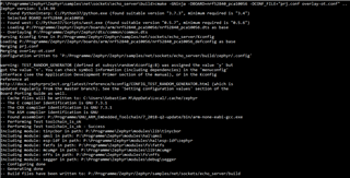

But there is a problem with programs who need C++ (CONFIG_CPLUSPLUS=y). When I try to build the "echo_server" sample vom samples/net/socket/echo_server with "cmake -GNinja -DBOARD=nrf52840_pca10056 -DCONF_FILE="prj.conf overlay-ot.conf" .." eveything seams to work so far:

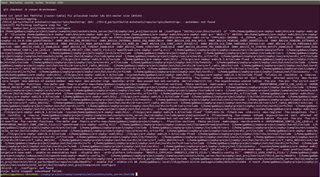

But, when I then run "ninja" to create .hex-File I get an Error:
"The command ".\bootstrap" can not be found or is written wrong"

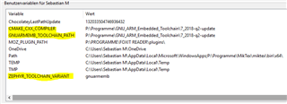

I'm using GNU_ARM_Embedded_Toolchain. I set Environment variables like this:

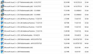

I also tried to install C++ runtimes but nothing happened.
