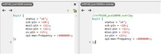

nrf9160_pca10090.overlay
&spi3 {
	status = "ok";
	sck-pin = <9>;
	mosi-pin = <8>;
	miso-pin = <7>;
	ss-pin = <10>;
	spi-max-frequency = <4000000>;

  • Yes this was also the root of the issue on my setup as well. However, on my setup after correcting the .overlay file name. SES can no longer load the project.
    The Fix I have found so far is to include the same lines in the ns.overlay file
    With the temporary fix, everything seems to be working as expected again. Any thoughts on how to fix this final part so I don't have to double include the same lines?
    you should have two overlay files in your project:
    nrf9160_pca10090ns.overlay
    Both these should hold the configuration for your spi peripheral. Since this is a Cortex M33, it has two regions
    * Secure (nrf9160_pca10090.overlay)
    * Non-secure (nrf9160_pca10090ns.overlay)
    Depending on which region you configure for, the .overlay file will be appended to the overall device tree source. I include both to make the example as generic as possible.
    Håkon
