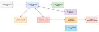

Hi Chris,
If you have a look at table 6.124 in Mesh Model spec, you can find that the model expand in to 2 elements. One is Main and one is Temperature. The Light Lightness Actual is bound to Generic Level on the Main element, and will not change state when the Light CTL Temperature change.
Hi Hung, thank you for your reply.
I understand what you are saying. But, In table 6.124 the light CTL set message is also present on the main model. This message sets the:
1. CTL Lightness
2. CTL Temperature
3. CTL Delta UV
Will this CTL temperature not be bound to the generic level on the main element?
Maybe I am missing something fundamental here.
Ah if you have a look at table 6.122, this pretty much clears it up.
The main element:
Light CTL is bound to:
1. Light Lightness
2. Light CTL Temperature
Light CTL Temperature Range is bound to:
1. Light CTL
The temperature element:
Light CTL Temperature bound to:
1. Light CTL
2. Generic Level
Generic level bound to:
1. Light CTL Temperature
Yes, it's pretty clear the CTL temperature bound to Generic Level on the temperature element.
