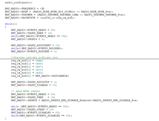

hello,
I want to use RSSI on nrf52832, and the project is uploaded.
the question is, I test the RSSI on channel 2468MHZ, the NRF_RADIO->RSSISAMPLE result is about -92dBm, then , I use another board send RF at 2468MHZ,then test the RSSI , but it's still about -92dBm, what's the matter?
