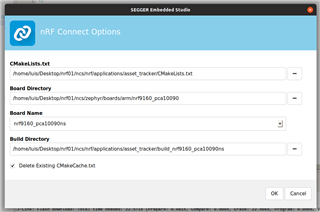

Steps to reproduce:
1) Open the asset tracker application with the nrf9160_pc10090ns board selected
 open nrf sdk project
2) I then connected the J-Link target and erased all of the memory.
3) Clean and build the Solution.
4) Download the merged.ihex file from the build folder.
