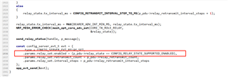

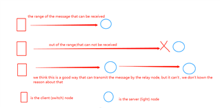

i did a test about the relay function as below:
Can anybody tell me why the message can't relay to the next node?
Thanks

Which Mesh SDK are you using? and which nRF device?
Can you provide me with more info about your test environment?
Is there any other bluetooth devices around when you are doing the test?
yes, i have found out the .params.relay_set.enabled = (p_pdu->relay_state == CONFIG_RELAY_STATE_SUPPORTED_ENABLED). and i never modify it.
I will update you when I have done the testing.
I have tested with the same boards and SDK on my side and everything seems to work fine. Have you tried with different boards? Can you also try downloading a fresh SDK and see if that makes andy difference?
