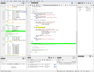

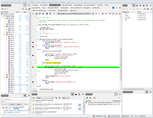

  • I've just tried this but I still see nothing in the Debug Terminal, even using printf.
    I tried putting this at the top of my sdk_config.h
    #define NRF_PRINTF_FLAG_AUTOMATIC_CR_ON_LF_ENABLED 0
    and when that didn't work I tried changing the sdk_config.h to
    #ifndef NRF_FPRINTF_FLAG_AUTOMATIC_CR_ON_LF_ENABLED
    #define NRF_FPRINTF_FLAG_AUTOMATIC_CR_ON_LF_ENABLED 0
    When I look in my subversion diffs for that file, this is the only line that is changed. This is for
    C:\nRF5_SDK_15.3.0_59ac345\examples\ble_peripheral\ble_app_uart
    The example uses both of these lines just before advertising_start() (line 738)
    printf("\r\nUART started.\r\n");
    If I type some text into the Debug Terminal by pressing keys on my keyboard then they appear in the window. So it's not because of editor colours or something silly. When I step the debugger I see nothing from printf or NRF_LOG_INFO
    I also checked my solution options but they look fine.
    Being paranoid cant hurt so I also changed the printf to printf("UART started."); to remove the escaped characters entirely but it still shows nothing. I then repeated the line 20 times to see if it was some weird buffering thing.

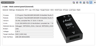

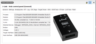

    My J-Link control panel looks like this
    All of this is running on Windows 10 but I had the same problem with Win7
  • At this point I'd really suggest going back to basics. Write a hello world program using the SES template which if I remember correctly imports all the RTT headers for you and you can call RTT directly. Just have it print, wait (you can use a simple loop) then print again. If it doesn't, just pull them in yourself and do it. See if that works with the debug terminal. If not, load up the code and connect up the JLink RTT viewer and see if you can get that to work.
    When you get to the point you can see RTT output, next thing is to find the RTT calls buried under the NRF macros, put a breakpoint in them and ensure they are actually being called.
    That thread Johannes linked to mentioned the RTT tab on the JLink control panel as another place you can see raw RTT output - have you looked there?
