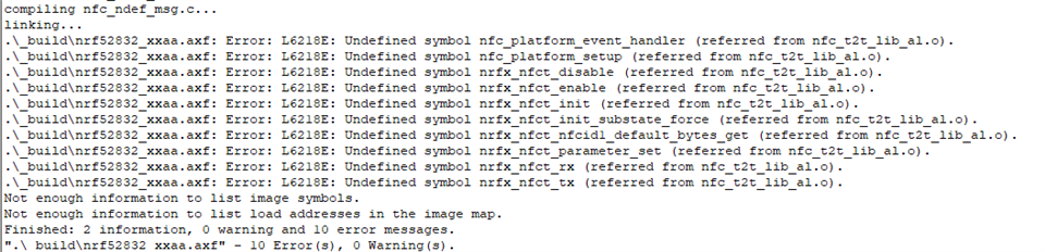

Hi, i'm using nrf52832 uploaded ble_app_beacon example.
I want nrf52832 to work as a beacon and as a nfc tag.
Thus, I added some nfc example code. nfc_t2t_lib.h also added in bla_app_beacon project file.
But, compile result have 2 errors.
 Error: L6218E: Undefined symbol nfc_t2t_emulation_start (referred from main.o).
 Error: L6218E: Undefined symbol nfc_t2t_setup (referred from main.o).
PLZ Can anyone solve this? thank you
    You need to include the precompiled NFC T2T library for your compiler, found in components\nfc\t2t_lib\nfc_t2t_lib_[compiler].a/lib

  • I added components\nfc\t2t_lib folder through keil "Options for Target > C/C++ / Include Paths.
    Is not your advice telling this?

    error: L6002U : Could not open file..\..\..\components\nfc\t2t_lib\nfc_t2t_keil.lib: No such file or directory.
    Clearly, it works in the record_text example...
    I added "components\nfc\t2t_lib folder through keil "Options for Target > C/C++ / Include Paths." and  I added the some C file after I created the group in the project window like record_text project window.
  • How exactly did you add the .lib file to your project? Did you browse the directories to locate it? The path reported in the linker output seems too short compared to where the lib is located in relation to the ble_app_hrs_rscs_relay example. If you did not move it, the path to the lib should be like this:
    ..\..\..\..\..\..\..\components\nfc\t2t_lib\nfc_t2t_lib_keil.lib

    The exact path is:  ..\..\..\..\..\..\..\components\nfc\t2t_lib.
    Now I am testing using the example in the same sdk (nRF5_SDK_15.3.0_59ac345\examples) and it is automatically added to Options for Target.
    The examples used are "nfc / record_text" and "experimental\ble_app_hrs_rscs_relay".
    And  I created the group file in the project window like record_text project window.
      But, an error still occurs...
    The results I just build are..
    Is there a way to solve it?..
  • These are different errors, indicating that you have not included source files for nfc_platform and nrfx_nfct driver. I see you have included nfc_platform.c in your project, also make sure you add the following file:
    modules\nrfx\drivers\src\nrfx_nfct.c

  • Jorgen, Thank you so much for kindly letting me know.
    I added several Paths and C files as you told me, and l got an error, but it was BUILD correctly after modifying it in sdk_config.h!
    I learned a lot about keil because of you. Thank you.
