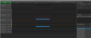

I am trying to execute the SPI slave example from sdk15.2 on my NRF52832 Dev board (PCA10040  1.2.1).
 I am using stm32f0 dev board as the master and transmitting the value 0x20 in a 100ms raster. I have tried using SPI clocks from 125k to 1M and I am facing the same error.
The RX buffer is getting filled with 0xFF no matter what data i transmit. I have posted my code below

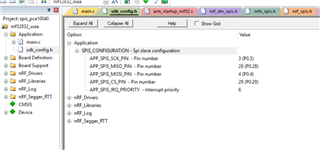

Here is a snippet from logic analyser
here are my pin configurations
Thank you.
