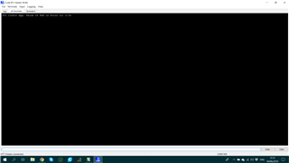

I am using nrf52840 and am trying to determine the parameters of a voltage divider using the SAADC. Vin is the VDD voltage of the chip, R1 is 4640 ohms and R2 is 38600 ohms (measured by using a multimeter). I have attached the Vout voltage to the AIN0 (P0.02) pin of the board and successfully did the ADC conversion of its value by calling the function value_of_voltage_on_resistor_2_in_volts(). I have managed to successfully display the value of Vout (the voltage on the resistor R2) to the RTT viewer terminal and the value is correct. Since I know the values of VDD (because I measured it with a multimeter, its value is 2.974 volts), R1 and R2, I calculated the value of Vout and determined that it has the value of 2.65 volts (I have also checked that value with a multimeter), and it turns out that I did that part correctly since that value was displayed on the RTT viewer. The problem is when I try to do the ADC conversion of the VDD voltage because for some reason on the terminal is outputted 2 volts instead of 2.97 volts. I do not know why am I not doing it correctly and also for some reason I cannot display the next line of NRF_LOG_INFO() to the terminal.  Can somebody please help me find the error? I posted the code, terminal output and the schematic picture of the circuit below. The code is not very long and I tried to make it easy to read.

	 /* 	NRF_LOG_INFO("Value of voltage on resistor_2 in volts is: " NRF_LOG_FLOAT_MARKER "\r\n", NRF_LOG_FLOAT(value_of_voltage_on_resistor_2_in_volts()));
			NRF_LOG_FLUSH();
		  nrf_delay_ms(1000);*/
			NRF_LOG_INFO("Value of VDD in volts is: " NRF_LOG_FLOAT_MARKER "\r\n", NRF_LOG_FLOAT(value_of_voltage_of_VDD_in_volts()));
			NRF_LOG_FLUSH();
		  nrf_delay_ms(1000);
			NRF_LOG_INFO("Value of resistance in ohms of resistor_2 is: " NRF_LOG_FLOAT_MARKER "\r\n", value_of_resistance_of_resistor_2_in_ohms());
			NRF_LOG_FLUSH();
		  nrf_delay_ms(1000);
