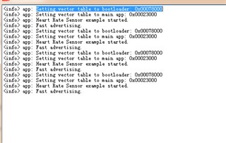

Fatal dfu log:Setting vector table to bootloader: 0x00078000
my code based on file "nRF5_SDK_14.0.0_3bcc1f7.zip".my hardware based on nrf52832QFAA.
my options set as:
project “bootloader_secure_ble”:
project “ ble_app_hrs ”with DFU services:
1、merge hex:hrs.hex、bootloader_secure_ble.hex、setting.hex、s132_nrf52_5.0.0_softdevice.hex
2、load in chip, and i get log like this:
3、erase all, load "s132_nrf52_5.0.0_softdevice.hex" and "bootloader_secure_ble.hex", i can discover the device:
is any wrong with project "ble_app_hrs"???but i can not find ,please help me.
exp:
change  "#define NRF_SDH_BLE_VS_UUID_COUNT 0" to "#define NRF_SDH_BLE_VS_UUID_COUNT 1", log prompt change RAM start and size,after charge as log,
i get :
device likes normal, is it? logs like "Setting vector table to bootloader: 0x00078000" is necessary?
