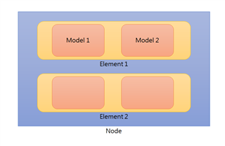

Can U tell me "Relay" is applicable to node or model?
Case 1 : Node have relay.
Case 2 : Element 1 have relay. Element 2 have not relay.
Case 3 : Model 1 have relay. Model 2 have not relay.
How many of the above 3 case are feasible?

QK-Huang said:Can U tell me "Relay" is applicable to node or model?
The relay-functionality is for the node itself. It won't differ between what kind of message you are relaying, so the models and elements doesn't have anything to do with relaying messages.
So, "Case 1" would be the only feasible case.
