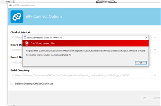

Last week I bought two NRF9160 DK. I downloaded the nrf connect on pc and then i followed the steps carefully from this webpage https://devzone.nordicsemi.com/nordic/b/cellular-iot-guides/posts/getting-started-with-nrf9160-dk
But (working on two windows 10 pro computers) I have issue when I followed this in the assistant :

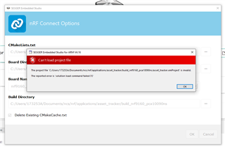

In Segger, after specifying Zephyr Base and GNU ARM Embedded Toolchain Directory , I opened nrF connect SDK project and followed the steps as above in the image... But unfortunately I have this error as in the image shows below :

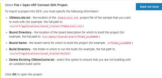

    Secondly, did you try using board name nRF9160_pca10090ns? There is a bug in the Getting Started Assistant v0.9.2, that shows nRF9160_pca10090 instead of  nRF9160_pca10090ns. When you choose nRF9160_pca10090 you will get the error message that you got. Both the Getting Started Guide in our blog and the Getting Started Guide from the NCS v0.4.0 documentation uses the nRF9160_pca10090ns board name.
    The reason for why we have both nRF9160_pca10090 and nRF9160_pca10090ns has to do with the complexity of the nRF9160. It is a Cortex-M33 MCU with TrustZone. From the NCS documentation:
    "The M33 TrustZone divides the MCU into secure and non-secure domains. When the MCU boots, it always starts executing from the secure area, which in this case is the Secure Partition Manager.
    To use any of the nRF9160 samples, you must first compile and flash the Secure Partition Manager sample. It provides a reference implementation of a Secure Partition Manager firmware. This firmware is required to set up the nRF9160 DK so that it can run user applications in the non-secure domain.
    Note that the Secure Partition Manager sample is automatically included in the build for the nrf9160_pca10090ns board."

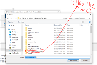

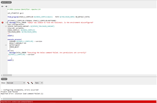

  • It worked on one computer where it generated all the projects. However, in the other computer it showed the error below. Please help to resolve the issue quickly.
  • What is the meaning of the error above stating "Zephyr was unable to find the toolchain. Is the environment misconfigured?
