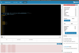

I would like to get AT Command Sample to work on nRF9160. I erased the module using Programmer software "erased all" and then loaded Secure Boot sample, then updated the firmware and then loaded the AT Command sample. However, AT commands used timed out.

    When looking at the LTE Link monitor, hit the reset button on the dev kit and make sure you see the secure boot stuff fly across the screen.  If not, it's not on there. In your picture it says AT Host started but doesn't have the secure boot text before it (trust me when it's there you will see it.  It's pages of text as it boots)
    I would say secure boot is not on your device.  When you programmed the AT client you erased the secure boot.
    You can use the GUI programmer by loading BOTH the secure boot and AT client hex code files and then program.  Or use the command line:
    nrfjprog --eraseall -f nrf91
    nrfjprog.exe --program Secure_Boot.hex --sectorerase -r -f nrf91 --verify
    nrfjprog.exe --program at_client.hex --sectorerase -r -f nrf91 --verify
    Then connect the LTE link monitor, hit the reset button on the dev kit, and check that you see all the secure boot stuff fly on the screen.  AT commands should work.
  • Also your talk about loading the Secure Boot sample makes me think you are on old code as well.  Secure Boot has been renamed SPM or Secure Partition Manager.  And there is new AT Client code that has the response to serial commands as an interrupt as opposed to being started from main.c.
    So I would update your radio firmware to the latest, 0.7.0_29 is the latest as I type this.  Update all the git repos, with west or git (follow the getting started example).  Open the AT Client project and make sure you use the _NS for board name.  And when you compile you will get a merged.hex.  That will be the SPM and AT client and that should work too.
