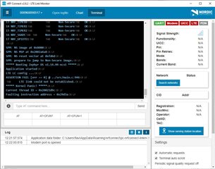

I get this error after i connect the board select the devise and press reset button
How can I resolve?

Hi Flavio,
Please make sure you have the latest modem firmware: https://www.nordicsemi.com/Products/Low-power-cellular-IoT/nRF9160/Download#infotabs
And make sure you are using NCS v0.4.0:
cd ncs/nrf git checkout master git pull git checkout v0.4.0 west update
Then build/flash as described here.
Best Regards,
Martin L.
