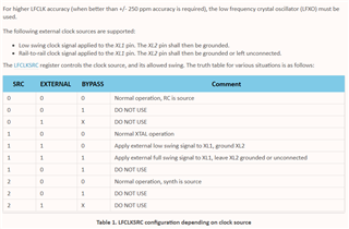

Hi
Please advise how to configure external clock instead using the internal.
Thanks
Hi
Thanks
Hi Josh
How to set LFXO to rail to rail was described in the link provided in my last reply.
Simon
Hi
maybe I miss something, How to configure the SoftDevice ,which type I need to choose?
// <0=> NRF_CLOCK_LF_SRC_RC
// <1=> NRF_CLOCK_LF_SRC_XTAL
// <2=> NRF_CLOCK_LF_SRC_SYNTH
NRF_CLOCK_LF_SRC_XTAL is the external LF clock.
Simon
Simon
