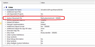

  • You,re probably missing the bootloaderSettings section in the flash_placement.xml file, take a look at the flash_placement.xml file from this answer.
    Best regards
    Bjørn
  • I have uploaded this image of upgraded SDK code. But in my 12.3.0 there is no option in linker of Section placement file.
    So there would be no effects of flash_placement.xml. whether I will do changes or not.

  • Hey I have resolved all my errors with this flash_placement.xml file
    <!DOCTYPE Linker_Placement_File>
    <Root name="Flash Section Placement">
      <MemorySegment name="$(FLASH_NAME:FLASH)">
        <ProgramSection alignment="0x100" load="Yes" name=".vectors" start="$(FLASH_START:)" address_symbol="__isr_vector" />
        <ProgramSection alignment="4" load="Yes" name=".init" />
        <ProgramSection alignment="4" load="Yes" name=".init_rodata" />
        <ProgramSection alignment="4" load="Yes" name=".text" />
        <ProgramSection alignment="4" load="Yes" name=".dtors" />
        <ProgramSection alignment="4" load="Yes" name=".ctors" />
        <ProgramSection alignment="4" load="Yes" name=".rodata" />
        <ProgramSection alignment="4" keep="Yes" load="Yes" name=".dfu_trans" inputsections="*(SORT(.dfu_trans*))" address_symbol="__start_dfu_trans" end_symbol="__stop_dfu_trans" />
        <ProgramSection alignment="4" load="Yes" name=".ARM.exidx" address_symbol="__exidx_start" end_symbol="__exidx_end" />
        <ProgramSection alignment="4" load="Yes" runin=".fast_run" name=".fast" />
        <ProgramSection alignment="4" load="Yes" runin=".data_run" name=".data" />
        <ProgramSection alignment="4" load="Yes" runin=".tdata_run" name=".tdata" />
        <ProgramSection alignment="4" keep="Yes" load="Yes" runin=".fs_data_run" name=".fs_data" />
        <ProgramSection alignment="4" load="Yes" name=".bootloaderSettings" start="$(BOOTLOADER_SETTINGS_START:)" size="$(BOOTLOADER_SETTINGS_SIZE:)" />
      </MemorySegment>
       <MemorySegment name="$(FLASH2_NAME:BOOTLOADER_SETTINGS)">
        <ProgramSection alignment="4" load="No" name=".bootloaderSettings"/>
      </MemorySegment>
      <MemorySegment name="$(RAM_NAME:RAM);SRAM">
        <ProgramSection alignment="0x100" load="No" name=".vectors_ram" start="$(RAM_START:$(SRAM_START:))" />
        <ProgramSection alignment="4" load="No" name=".fast_run" />
        <ProgramSection alignment="4" load="No" name=".data_run" />
        <ProgramSection alignment="4" load="No" name=".tdata_run" />
        <ProgramSection alignment="4" load="No" keep="Yes" name=".fs_data_run" address_symbol="__start_fs_data" end_symbol="__stop_fs_data" />
        <ProgramSection alignment="4" load="No" name=".bss" />
        <ProgramSection alignment="4" load="No" name=".tbss" />
        <ProgramSection alignment="4" load="No" name=".non_init" />
        <ProgramSection alignment="4" size="__HEAPSIZE__" load="No" name=".heap" />
        <ProgramSection alignment="8" size="__STACKSIZE__" load="No" place_from_segment_end="Yes" name=".stack" />
        <ProgramSection alignment="8" size="__STACKSIZE_PROCESS__" load="No" name=".stack_process" />
      </MemorySegment>
      <MemorySegment name="$(FLASH2_NAME:FLASH2)">
        <ProgramSection alignment="4" load="Yes" name=".text2" />
        <ProgramSection alignment="4" load="Yes" name=".rodata2" />
        <ProgramSection alignment="4" load="Yes" runin=".data2_run" name=".data2" />
      </MemorySegment>
      <MemorySegment name="$(RAM2_NAME:RAM2)">
        <ProgramSection alignment="4" load="No" name=".data2_run" />
        <ProgramSection alignment="4" load="No" name=".bss2" />
      </MemorySegment>
    </Root>
    But I don't know what should I add in options ->build->memory segments and options->linker->Section placement macros to run this dfu bootloader_secure code in segger embedded studio
