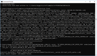

Transferring BMI160 sample example to nRF9160 samples
I am working on transferring BMI160 sample given in zephyr samples (\ncs\zephyr\samples\sensor\bmi160) to nrf sample (\ncs\nrf\samples\nrf9160\bmi160).
Below is the changed bits:

Main.c and CMake file are the same as provided in the sample and I get following error related to GPIO controller.
What could be the reason? Is it asking for an actual port and pin numbers? Thanks for your support.
