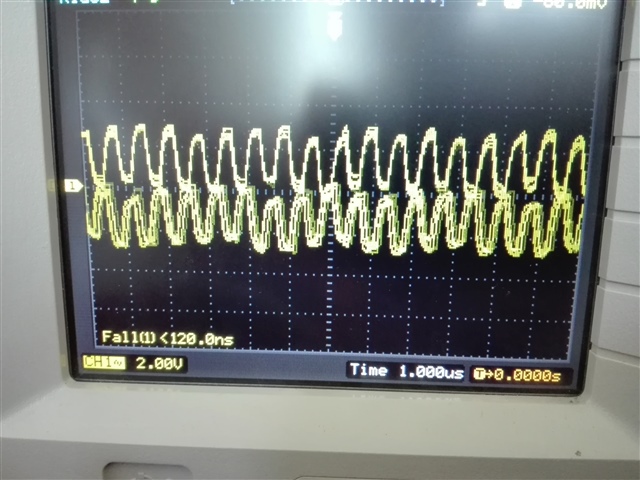

I am trying the demo from github (https://github.com/andenore/NordicSnippets/blob/master/examples/i2s_master/main.c) with nrf52 demo board and when checking the signal on BCLK I see that it is doubled. Like
Any ideas why this is happening?

This type of signal is normally due to bad grounding. Could you check your connection and see if it improves?
Håkon
Yes. It looks like it was really a GND issue. Not sure what I did, but managed to get the proper signal to the screen.
