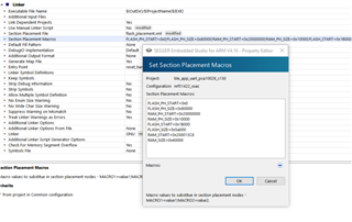

The first thing that makes me doubtful is that I had to declare an SRAM segment in my memory segment config, under the build menu of the project setings. This is shown like this :
FLASH RX 0x0 0x00040000;SRAM RWX 0x20000000 0x00008000
Also, I'm not sure of the starting address of both FLASH and SRAM.
Indeed, I've seen in this tutorial from Nordic that the FLASH and RAM memory should have very specific starting addresses, and I tried to do so in the section placement macro under le Linker menu, using the values for S130 v2.0.1, namely  0x200013C8 for RAM and 0x1B000 for FLASH.
The problem is, when I do so, that the debugger is stuck, I don't know why, without me launching it and isn't throwing any error, just saying he's running :
So to have access to the debugger, I have to remove all of my section placement macro configuration. I would realy apreciate if someone could tell me why I don't have anymore access to the debugger when I add any section placement macro. It looks like my device isn't responding anymore, even if he's still connected.

  • Yes I've been confronted to this problem, and so 'ive used this guide. But I've made some tests and there were two major issues
    -Indeed the flash-ram memory placement
    -Also the fact that I had to load the SDK .hex file in my project configuration.
    The debugger was stuck because I had to erase all of my previous config from the device, which was at a wrong memory segment.
