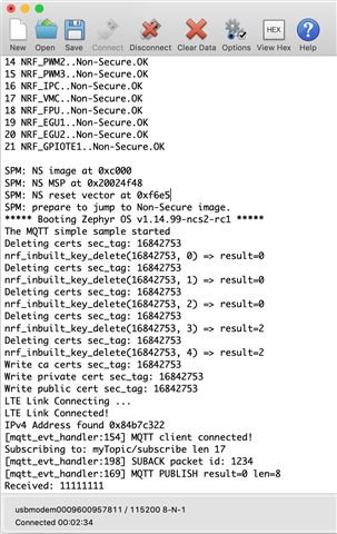

How to use MQTT+TLS in nRF9160?
I'm working on a project using nRF9160 DK.
How can you use MQTT+TLS in nRF9160?
Where should ca certificate file be stored?
I modified the code below in mqtt_simple project. What code should I modify additionaly?

  • I modified code but it doesn't work well... Could you give me advice?
    I tested mqtt broker(mosquitto) with tls with another MQTT client and it works fine. The broker should be ok.
    The broker doesn't receive message from the client in this project.

    ***** Booting Zephyr OS v1.14.99-ncs1 *****
    The MQTT simple sample started
    LTE Link Connecting ...
    LTE Link Connected!
    IPv4 Address found 0x5e7fda12
    ERROR: mqtt_connect -45

    I copied main.c code below to my project and modified it a little bit.
    https://github.com/joakimtoe/fw-nrfconnect-nrf/commit/36532a8ca60bf7139a988b5cbb4e6cb47948a9fa
    I defined NRF_CLOUD_CLIENT_ID in main.c instedf of in certificates.h

    	printk("The MQTT simple sample started\n");
    	provision_certificate();
    	modem_configure();
    	client_init(&client);
    	err = mqtt_connect(&client);
    	if (err != 0) {
    		printk("ERROR: mqtt_connect %d\n", err); // eror here

    		printk("LTE Link Connecting ...\n");
    		err = lte_lc_init_and_connect();
    		__ASSERT(err == 0, "LTE link could not be established.");
    		printk("LTE Link Connected!\n");
    static int provision_certificate(void)
    #if defined(CONFIG_PROVISION_CERTIFICATES)
    #if defined(CONFIG_BSD_LIBRARY)
    		int err;
    		/* Delete certificates */
    		nrf_sec_tag_t sec_tag = (nrf_sec_tag_t) sec_tag_list[0];
    		for (nrf_key_mgnt_cred_type_t type = 0; type < 5; type++) {
    			printk("Deleting certs sec_tag: %d\n", sec_tag);
    			err = nrf_inbuilt_key_delete(sec_tag, type);
    			printk("nrf_inbuilt_key_delete(%u, %d) => result=%d\n",
    				sec_tag, type, err);
    #if defined(CA_CERTIFICATE)
    		/* Provision CA Certificate. */
    		printk("Write ca certs sec_tag: %d\n", sec_tag);
    		err = nrf_inbuilt_key_write(sec_tag,
    			NRF_KEY_MGMT_CRED_TYPE_CA_CHAIN,
    			CA_CERTIFICATE,
    			strlen(CA_CERTIFICATE));
    		if (err) {
    			printk("CA_CERTIFICATE err: %d\n", err);
    			return err;

  • Hi, KentaM. Thanks a lot!!
    I'm still in trouble. This is the console print.
    SPM: NS image at 0x8000
    SPM: NS MSP at 0x200240f0
    SPM: NS reset vector at 0xb811
    SPM: prepare to jump to Non-Secure image.
    Deleting certs sec_tag: 16842753
    nrf_inbuilt_key_delete(16842753, 0) => result=2
    ***** BUS FAULT *****
      Precise data bus error
      BFAR Address: 0x3b61bb53
    ***** Hardware exception *****
    Current thread ID = 0x20020410
    Faulting instruction address = 0x16ad8
    Fatal fault in thread 0x20020410! Aborting.
    nrf_inbuilt_key_delete(16842753, 1) => result=14
    nrf_inbuilt_key_delete(16842753, 2) => result=14
    nrf_inbuilt_key_delete(16842753, 3) => result=14
    nrf_inbuilt_key_delete(16842753, 4) => result=14
    Write ca certs sec_tag: 16842753
    CA_CERTIFICATE err: 14
    LTE Link Connected!
    ERROR: getaddrinfo failed 22
    ERROR: mqtt_connect -47
    This may tell me that certification files are wrong, but MQTT+TLS works fine with another MQTT client with the same three files(CLIENT_PRIVATE_KEY, CLIENT_PUBLIC_CERTIFICATE, CA_CERTIFICATE). These files are self signed and generated by openssl.
    In my case, I don't use AWS IoT service. I implemented mosquitto MQTT broker on EC2.
    Do you have any comment?
    <certificates.h> *under the src folder
    #define CLIENT_ID "myClientID"
    #define CLIENT_PRIVATE_KEY \
    "-----BEGIN RSA PRIVATE KEY-----\n" \
    "MIIEowIBAAKCAQEAyoE5FG1Hf9DFEA1iF9enHtxNGYXI2kBjtXlz9Ckclctx2vJx\n" \
    "QknwSFmfYXNRetEcDylKQEI3mkHxtj/jkDrOLitk0ccNQAeou/cL\n" \
    "-----END RSA PRIVATE KEY-----\n"
    #define CLIENT_PUBLIC_CERTIFICATE \
    "-----BEGIN CERTIFICATE-----\n" \
    "MIIDkjCCAnoCFGlpDDWDAA00v8MltxDoTLzJH6EiMA0GCSqGSIb3DQEBCwUAMIGJ\n" \
    "yQyqplp/\n" \
    "-----END CERTIFICATE-----\n"
    #define CA_CERTIFICATE \
    "MIID9TCCAt2gAwIBAgIUSQtJI7ktYmj7qE3tDGGlDTjxrWAwDQYJKoZIhvcNAQEL\n" \
    "jmLwN36BmvVGOkXHwOaBgCbFon1negAwX7bO0fXJlwySKO/gIvo1B/FZnP3TdRoD\n" \
    "agXksMq8cbMC\n" \
  • Ah....
    I use AWS IoT Core without using EC2.
    Because it costs a lot for EC2 instances.
    If the MQTT_MESSAGE_BUFFER_SIZE is too long it will result in a BUS FAULT error.
    日本語でも書いておくと、EC2インスタンスではなく、AWS IoT Coreを使っています。
    EC2インスタンスだとお金いっぱいかかるので。
    AWS IoT Coreでエッジデバイスを登録して、証明書とポリシーを設定及びアタッチしてあります。
    BUS FAULTのエラーはMQTT_MESSAGE_BUFFER_SIZEが長すぎるとエラーになったように思います。
