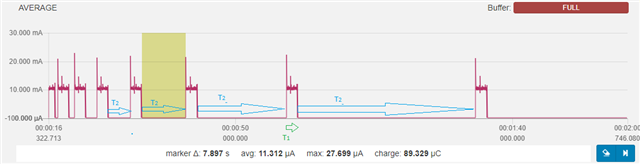

I'm using NRF52840 module to make a customer device. I'm using nRF5 SDK for Thread and Zigbee v3.0.0.
I have a Thread mesh with some routers devices and one child, Periodically, the child leave the mesh when it goes out of range of any node in the network. I would like to know how to improve the current consume.
If I plot the current consume versus time (see attached figure), I can see serveral re-attach processes. The first retries are very close in time, and then the interval increases as 2^n, (n is the try number). Also, I can see that the duration timeout of each try is about 2 seconds.. Is this correct?
I would like to know if this timeout and interval period can be set or modified.
I have taken a screen shoot with nrf Connect Power Profile, In this picture I have observed that the check timeout(T1, green arrow) is 2 seconds and the time between retries(T2, blues arrows) is 2^n seconds (n is the number of times when the child can't attach).
Can I set this periods?
