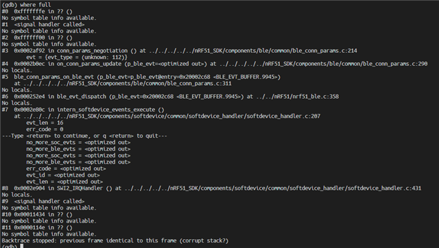

Hello, my old question: https://devzone.nordicsemi.com/f/nordic-q-a/48087/nrf51822-s130-hardfault-error
I found something.
After removing -fdata-sections in makefile, Hardfault error in my old question never occur.
What is role of data-sections flag?
I want to know purpose and role of this flag.

  • This is what happens when I try to access the wrong handler address.
    my actual handler address is 0x200010 (example).
    and compare value of variable containing handler address in another module.
    it is contaminated partially.
    (gdb) print actual_handler
    0x200010
    (gdb) print m_evt_handler ( in another module)
    0x2000ff
    so I try to debugging upper m_evt_handler address.
    (gdb) x/256b (m_evt_handler address-0x80)
    0x20004a58 <m_read_buf>:        0xff    0xff    0xff    0xff    0xff   0xff    0xff   0xff
    0x20004aXX <m_read_buf>:        0xff    0xff    0xff    0xff    0xff   0xff    0xff   0xff
    0x20004aXX <m_evt_handler>:        0xff    0x00    0x20    ....
    and I check the usage of m_read_buf in my code. and I found overrun bug.
