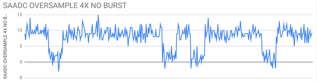

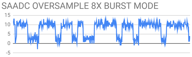

Q3) I have a small offset signal on my adc pin courtesy the analog circuitry. So I would exepect a mean value about 4 or 5.
When the calibration routine is triggered, the ADC value measured jumps up and then goes back down the next time the calibration routine is triggered. This is observed in the following graph. Sometimes, it fluctuates between a couple of calibration routines, and at other instances, it takes a longer time for the shift to happen. Each of the instances where the level shifts is when a calibration was triggered. The analog signal itself remains unchanged. What might be causing this and how can I overcome it? This behavior is not observed when calibration is turned OFF, so it seems like the calibration is somehow causing this.
I am trying oversampling since plain sampling has more noise in it. Here is a graph:

    A1) I would not recommend that you trigger the tasks directly when you use the driver, as this can leave the driver in an unwanted state. If you follow the example, it should, however, be possible to do this inside the handler, when you receive the NRF_DRV_SAADC_EVT_CALIBRATEDONE event, before setting up the buffers again. The driver will at this point be in IDLE state while setting up the buffers should trigger the START task again.
    A2) Unless you are sampling a signal close to GND, this is not expected and indicates that the workaround for the errata did not work.
    A3) This looks a bit strange, but it could be that the calibration algorithm will end up with different offset value, based on noise levels. In general, it should be sufficient to run offset calibration at the start of the program, and if there are major temperature changes.
    A4) Any gain settings should work, as long as the sampled signal is within the input range and below VDD. What exactly stops working when you set gain=1/3?
    Jørgen
  • Hi Jorgen,
    Thanks for the answers.
    - I believe there is something timing or priority issue with my app's advertise routine and the SAADC. When I enable advertising, the moment the calibration routine is completed, my program is off into the weeds. I have a reproducible code attached here. Can you please take a look and may be point me to what may be causing a problem? It also has the errate workaround in the CALIBRATEDONE event of the callback.
    - Why the calibration is jumping between values is still a mystery to me.
    Gain setting issue - I am not sure why, but a gain of 1/3 does not work with this app. May be you can help clarify? The callback never gets called after the first calibration.
