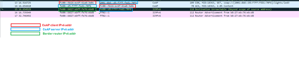

CoAP client application can't reach nrf52840 CoAP server whereas IPv6 pings work
Hello all !
So here is my problem, I have a computer as a CoAP client running the Python script from :https://infocenter.nordicsemi.com/index.jsp?topic=%2Fcom.nordic.infocenter.sdk5.v15.3.0%2Fiot_sdk_user_guides_linux_commands.html&cp=5_1_5_5_0_5
I connect a nrf52840 DK running the CoAP server example through a Raspberry Pi used as border router.
Pings from my computer to the nrf52840  works fine and I can see the CoAP Get requests directed to my CoAP server from my computer on Wireshark.
However the nrf52840 doesn't seem to receive the request and nothing happens on the DK (and the computer doesn't receive a response).
I have the folowing logs on Segger:

    I think I've found the source of the problem.
    Here is a capture I did on the border router :
    On the top line CoAP client requests from its global address the global address of the CoAP client.
    On the second line from the top, the CoAP client responds with its local-link address.
    On the third line the border router tells the CoAP client that it can't reach this address as it is out of scope from a link-local address.
    For the example to work, on the second line the CoAP client should use its global address (2001:db8::xxx).
    We can verify it by looking at the capture from a ping between the client and the server that works:
    Here we clearly see that the nrf52 client responds using its global address.
    So do you have an idea why the nrf52840 DK would answer using its local-link address instead of its global one ?
