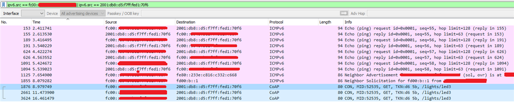

Pings from my computer to the nrf52840  works fine and I can see the CoAP Get requests directed to my CoAP server from my computer on Wireshark.
However the nrf52840 doesn't seem to receive the request and nothing happens on the DK (and the computer doesn't receive a response).

    The server does not seem to reply.
    The IP seems to be 2001:db8::d5:f7ff:fed1:70f6. This amounts to 5 byte BLE address, d5:f7:d1:70:f6, looks like you're missing a byte?

  • Ah, yes. You're right. The coap example reads out the BLE address, and sets it as public (upper bits set to '00'), but it was a bit suspicious that the remainder of the byte was all zero's, but then I noticed that the FW actually sets the whole byte to 0..
    I just tested the example, with #define BLE_6LOWPAN_LEGACY_MODE 0, in ubuntu 19.10. Which coap-client are you using? If you're using libcoap-2-0-bin, I couldn't even get anything out (wireshark concluded the same, req was not sent from PC -> device)
    installing libcoap-1-0-bin, then use coap-client to get, it started working:

  • Thanks a lot for taking the time to realise these tests !
    I did as you suggested and made work the example from border router with libcoap-1-0 with local-link address.
    I Set a second Rpi as Client for test that successefully pings the nRF52840 through the border router (replacing the PC in my previous example). I downloaded the same libcoap as the border router and sadly it doesn't work.
    On my PC I used the Python script from https://infocenter.nordicsemi.com/index.jsp?topic=%2Fcom.nordic.infocenter.sdk5.v15.3.0%2Fiot_sdk_app_coap_server.html&cp=5_1_4_2_4_1_0_4&anchor=iot_sdk_app_coap_server_python_sample
    I guess my routes are the problem, but if it is the case how come I'm able to Ping from the Client ??

  • Do you have any firewall running? Is ipv6 forwarding enabled?
    There's a thread on this subject here: https://devzone.nordicsemi.com/f/nordic-q-a/5481/making-ipv6-device-available-on-the-internet/19137#19137
    Could you check if any of these steps are configured incorrectly on your side?
